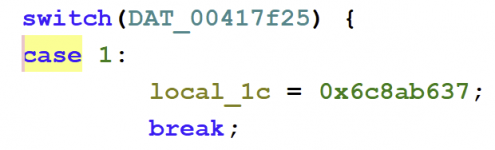

As a followup, I recently purchased 2 Radtel RT-4D from Amazon (https://www.amazon.com/dp/B0DMF898GV). They shipped, and arrived simultaneously, but with different versions that seemingly default to RC4 keys (I did not try adjusting via CPS, using radio default keys) in turn hitting "case 1" from @DualTachyon's original response above. This obviously mirrors @Razorback55's experience. The exact DMR versions are noted below given we determined it was the DMR chip firmware that had the issue, as opposed to the radio firmware.
one shipped with:
DMR version 01.00.00.52
Firmware version RT-4D DMR Radio V3.12 2024-12-06
Sync: +DMR MS/DM MODE/MONO | Color Code=00 | PI
Slot 1 DMR PI H- ALG ID: 01; KEY ID: 01; MI(32): 6C8AB637; DMRA Compatible RC4;
the other shipped with:
DMR version 01.01.00.19
Firmware version RT-4D Test V3.13 2025-01-08
The "MI(32): 6C8AB637" is obviously 0x6c8ab637 in the switch statement.

therealkf
May 11, 2025
34
4
  • rc4keyfinder.pdf
doriboni
Oct 31, 2023
127
51
Yes, but this method only works on ARC4 (it doesn't work with AES) and it finds the key. So it's a long time (several days) while the method I'm talking about only takes about a few seconds on a modern computer and doesn't find the key but decrypts the ciphertext only if the MI is fixed.
We are talking in this topic about a security flaw on Chinese radios, nothing else.
therealkf
May 11, 2025
34
4
Understood! There is an "Anytone" mode in the arc4keyfinder program as I *assumed* it was related to this flaw, and that it made the program handle its internal attack *differently*. Sadly there isn't much documentation, and it appears that code is from 2019. It just randomly seemingly *surfaced* for unknown reasons recently. FWIW I think Anytone 878 was the first place folks noticed this now ubiquitous static IV issue: Anytone - Anytone 878 RC4 and AES
therealkf
May 11, 2025
34
4
On a related note... I was looking into the other radios with this bug, and they seem to often use Auctus A6/A7/A8/A9 chipsets. The of course have their own DMR stack, so I wanted to see the logic that created the flawed static IV's. Finding firmware was a pain, but a random Russian forum had it here: https://4pda.to/forum/index.php?showtopic=1097462 (scroll to bottom)
I've attached the python code to make firmware_bao_dr1801uv_BF1801_DMR_AES256V001.05.lod from firmware_bao_dr1801uv_BF1801_DMR_AES256V001.05.zip (linked above) into a readable format that one could analyze.

doriboni
Oct 31, 2023
127
51
Indeed, the most interesting thing is to directly check the security of AES in Chinese radios and not to waste time with ARC4, because this fixed IV problem allows AES conversations to be decrypted without knowing the key, which is a major security flaw on these Chinese radios.
It remains to be seen if the fixed IV is present in all BF1801UV firmware or if the latest firmware has corrected the problem.
