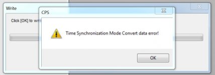

I have a PD565 Im struggling with importing a contacts file.
Having previously exported and edited a small group of contacts for many hours it failed to import. I gave up believing I had edited the file in some way which corrupted it.
The list has grown now so large that importing and editing will save me time if I can get it to work.
I then tried exporting a contact list (.xls) again, not editing anything at all and attempted importing the unedited file again and it fails with:
Is this a CPS issue or Windows?
Cheers
