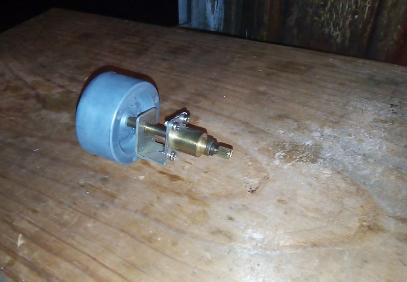

it has a slide tuner, but I highly doubt the action is anywhere as nice as a stereo receiver.
yep. I got one word for that radio. and that word is...
*thunk*
The radio shown has a very nice slide action, just like your stereo receiver. Both the Main Tuning and the Band Spread have the same mechanism as your radio. I have a Lafayette HE-30 receiver, that I obtained around 1966, and it has tuning similar to the Heathkit above, and almost any stereo receiver. My Marantz SR 6010 DC Receiver/Amplifier also has the same kind of tuning. It receives FM stereo very nicely. I don't think I have ever used it on AM.
What your stereo receiver doesn't have is:
  • A calibrator
  • A mode switch (BFO for CW/SSB)
  • The ability to turn off the AVC
  • A automatic noise limiter
  • A RF Gain
  • A Band Spread for fine tuning.
All of which are pretty necessary for a usable short wave receiver.
