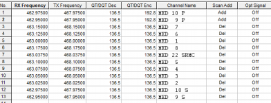

Here in the Metro, Med 10 is used as AAS dispatch, Med 9 is used as AAS On-Call (For units on a call that is), Med 2 is AAS dispatch used by units coming into town (We call it OOT for out of town), Med 3 is the VA ED, Med 6 is for Lovelace ED'S, Med 7 are Presbyterian ED's, Med 22 is for SRMC ED, and Med 1 is UNMH ED.
Meds 9, 10, 1, and 3 are all repeaters. Med 6 and 7 are not. I can't remember if 22 is or not right now. I don't think so though. There is a Med 9 and 10 repeater at Presbyterian Downtown and on Sandia peak. Same frequency, different PL access. As far as I hear and understand, all air and ground units talk on the same sets.

PS, there's also a Med 9 and 10 East Mountains (EM) that's actually on Med 120-something I think. I'll have to see if I still have that written down somewhere. It's use is the same, it's just on the other side of the mountain for the AAS unit out there.
