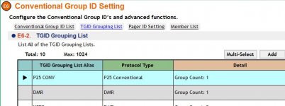

3) Do I need to setup the conventional group ID list? I see here that under DMR TGID it asked for DEC & Hex again. Do I need this for conventional DMR frequencies.
Yes you need to tell it what talk group it is.
