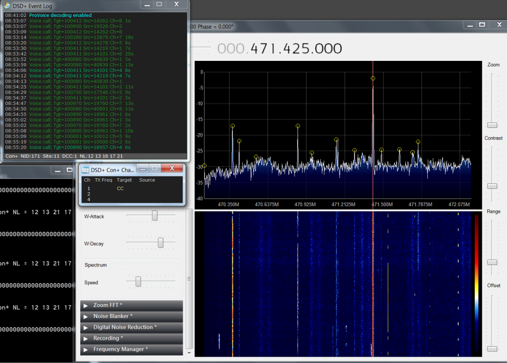

Folks,
I have a question about monitoring the local wide area connect plus.
I see (or at least I think) there are eight channels at this Connect Plus site, as indicated by the "Con+ Channel Activity" window, and I believe the control channel is on 471.425 slot 1, so far so good.
Few seconds later I see DSDplus shuffled the channel plan and now it moved the control channel to "1"
Is this an indication that the site is not getting a good lock? Also, does the "Con+ Channel Activity" really showing CH 1 and CH 2 as "Freq 1-Slot 1 and Freq 1-Slot 2"?

Well, the control channel will periodically change frequencies, but typically not too often. So it is possible that it just happened to jump while you were watching it.
Yes. Some people find this confusing, but it makes sense to me. I guess the only alternative would be '1-1, 1-2. 2-1, 2-2' sort of thing. So frequency 3 slot 1 would be CH 5.

If I am correct, this is showing a 4 channel site, because there are 2 voice slots per frequency.
So frequency 1 is voice slots 1 and 2, frequency 2 is voice slots 2 and 3, and so on.
A trick that I use, (if you have a second computer available), is to watch the control channel on one computer to monitor activity, and use the second to find and follow the voice frequency. On the systems where I live, the CC seems to prefer the frequency that has voice slots 1 and 2 when idle, but it does move around somewhat when there is voice activity, and then returns to the frequency with voice slots 1 and 2.
I don't know if this is the same for your system, perhaps someone else can shed some light on this.
I've seen the same thing happen when the control channel didn't change - DSD+ simply lost the sync for a second. It resets all the info on the Channel Activity window.
I like:
1A
1B
2A
2B
3A
3B
Very clear to see the LCN and the slot "number".
