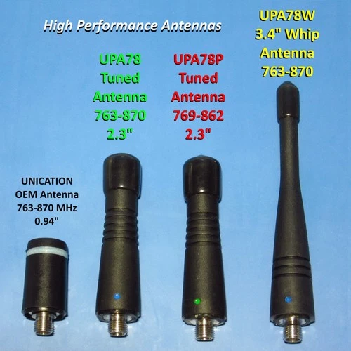

I had a $20 eBay gift card so decided to pull the trigger on an aftermarket 800 mhz antenna for the G4/G5.
https://www.ebay.com/itm/257270324557
The antenna shipped remarkably fast and looks beautiful on the scanner.
However signal reception is most important and I found it gets either the same or more often a bar or two less on distant sites than either the blue or purple band OEM Unication antennas.
Overall, I'm not gonna use this antenna in the future and continue to use the OEM or Kenwood K32 antennas.

These ones specifically have the correct anntenna connector, same as the OEM ones.

Hello cubn, It seems that the tuned UPA78W with +4dB gain is causing internal RF overloading of your Unication pager receiver caused by the strong signals in your area from the many high-power UHF Digital Over-The-Air TV broadcast stations in Indianapolis. This overloading symptom is confirmed by have less signal bars with the UPA78W antenna than with the proven under performing OEM antenna on your P25 police signals. The tuned UPA78 or UPA78P antennas would be a much better choice for your strong signal area since they are made to ignore, reject, and filter out signals occurring outside of the 700/800 public safety band.

The reception reports that @cubn posted does not indicate RF saturation. It indicates an antenna that provides less signal than the OEM antenna. The OEM antenna has an impressive performance, especially for it's size. I have a 3dBd antenna for 700/800 that is 10 inches long. It provides about 2-3 dBm increase in received signal and I have not observed RF saturation issues using it with the G5. Although that antenna increases received signal a little bit, I don't use it with the G5 because it has not improved performance in any meaningful way, and is 10 inches long. I had bought that antenna for my BCD325P2. But it does not stay on it either. I now use it on the HP2.
In the US, digital TV is not broadcast in the 763 to 870 Mhz range. The upper limit of TV is 608 MHz. Therefore, it would not be likely that it is interference from TV broadcast. Cellular telephone is within the 600 to 900 MHz range along with Public Safety between 763 and 870 MHz. I have had my G5 connected to a 6 dBi (3.85 dBd) mobile antenna and never had RF saturation, even within 100 feet of a cellular site 100 feet above ground, that I have purposely tested the G5 near because that site wipes out my SDS100 just using the Uniden OEM antenna.
The G5 OEM antenna works so well, that it is the only antenna that I use with it now. Reception in the car with the G5 sitting in the cup holder is very impressive. I don't connect it to the mobile antenna. I have only done that a few times testing.
