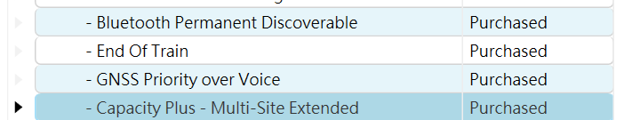

Another thread a user posted this from radio, it seems to be an EID option called End Of Train. I know what an EID is. It seems railroad related. I know what End Of Train transmissions are. I've previously decoded on SoftEOT. So what exactly is this feature to a radio? What does it do and meant for? Does it show the EOT decoded data on the radio for the conductor while working on ground?

It's described in the CPS as
End of Train
Description
This feature allows you to enable or disable the EOT mode. When the radio is in EOT mode, the frequency scanning will stop if a carrier is detected. You can resume the scan with XCMP Scan Resume Command. FFSK decode is supported in EOT mode. This is a radio-wide feature.
Note
  • This feature is only applicable for Single Site mode.
  • This feature depends on the Digital feature.
I'm guessing the scan logic is because EOT frequencies aren't all the same outside North America.
Further poking around seems to point at the XiR P8808R, a 3 button version of the DP4000/XPR7350. I bet somebody is using one as a EOT transmitter in Asia.
