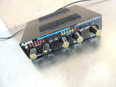

If you do get an amp you will also need a compressor my friend. An amplifier will make the quieter ones louder but then the normal ones will be screaming. A compressor will let the quieter ones through but and louder ones will automatically be limited. It's a kind of automatic volume control. I have one of these.
