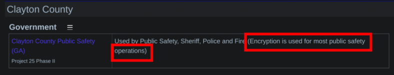

I've been away from the scanner world for over ten years. I am looking to get back into it, but my have things changed! I wanted to verify that the agency I'm most interested in is available. I've seen it online, but the feed doesn't work. Is there a way to determine if the agency can be monitored? I would hate to buy a new scanner, but I can't listen to them. What say you?
Unassuming2
Apr 21, 2024
12
Sorry about that. The agencies I'm interested in are in Georgia, specifically, the South Fulton and Clayton County PDs.

Nope, our system is 100 percent P25 TDMA. No analog trunking left in metro Atlanta. Everything is P25 and most TDMA. Gwinnett, Clayton and Walton are 100 percent encrypted public safety wise so no scanner will receive those whatsoever.
