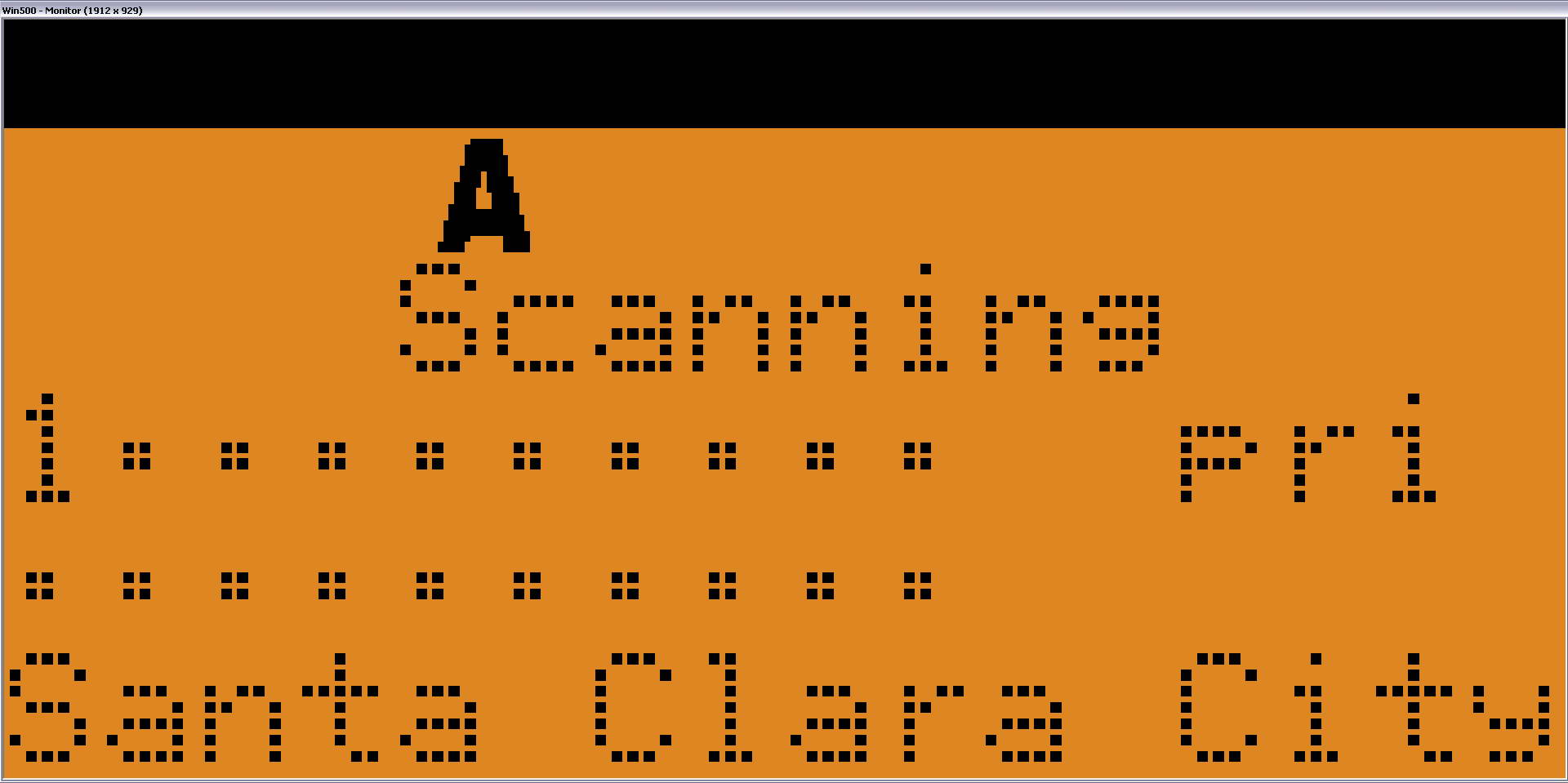

I really like the extra large display mode it gives you for controlling your scanner. Really easy to see from across the room when you have it running on your computer and happen to not be close to the computer or scanner.
Like this?

Win500 can if you're also running the remote client software. That screen is definitely larger, Don, but I find the extra large display of PSREdit500 to be easier to read with it's smoother font. Not knocking your program, WIN500 is a fine piece of software, but I prefer the other remote display.
