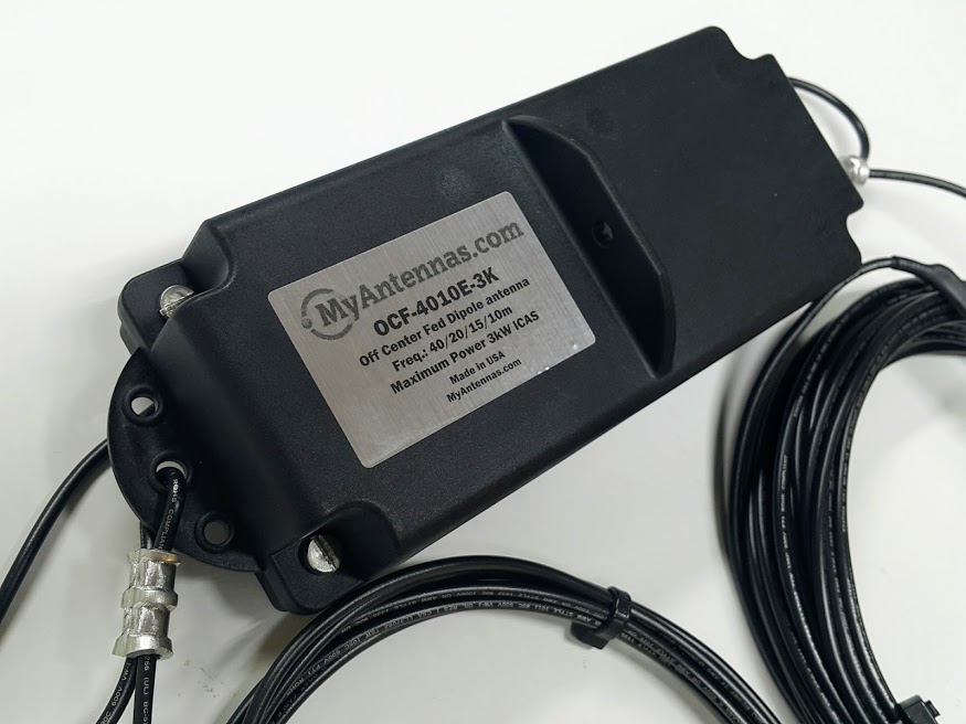

I was going to suggest an Off Center Fed inverted V, but you just posted the 25' apex. If you could do 35' it would help. The legs then slope down or could be horizontal or some of this and some of that. It's reasonably forgiving, but if both legs were horizontal the TX/RX would be improved broadside. I have mine in an inverted V, not horizontal at all and it works well on 40 and 20.
Review this type of antenna. It will put more RF options into your brain, even if you decide against it. Adding their RF choke at the feed point as well reduced my noise level significantly, but that's my location. Other operators have added an additional choke at the radio which reduced their noise floor further.
