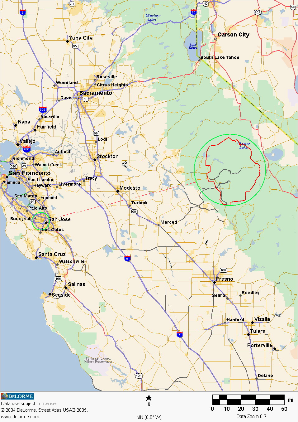

I do understand the HP-1 range vs. RRDB settings. However, when I select my 95051 ZIP code, I certainly don't expect to hear (or even try to hear) much from Alameda County, much less anything from Santa Cruz County or Yosemite National Park.
Don, when you set the location via using a zip code, the scanner automatically assumes a range, I am not sure what it is but when I punched in your zip code on mine and looked it came up as 10 miles. Now would that be a 10 mile radius around the area for the zip code, or a 10 mile radius from the center of the zip code? I don't know and maybe some of the more knowledgeable folks can comment on that. Santa Clara Co. is bordered by Alameda Co. and Santa Cruz Co. Since neither are a round shaped county, which is impacted by the problem of only being able to define circles in the DB, why do you find it strange that your circle and each of those circles intersect?
As for Yosemite NP, well that is a problem that the regional DB Admin needs to address. Since there is no location data set for Yosemite, indeed none set for the agency "National Parks" in the DB (CA state), I suspect that anyone that falls within the circle of the state will have the Yosemite NP frequencies show up in their HP-1 selected database. However, based on the size and shape of Yosemite, once the location data is set, I suspect Santa Clara will still fall within the circle covering Yosemite.
I wasn't using the default range. I set the range to 3.0 miles, presuming that this would affect what's selected. I do understand the problem with circles (e.g. a circle that includes California also contains most of Nevada, and a circle that contains Santa Cruz County also includes a pretty good chunk of Santa Clara County).
However, I was thinking that a "new" user might be confused and/or frustrated when he's more than 9 miles from another county's boundary, that county is on the other side of a mountain range, and the scanner spends time trying to receive traffic from that county, even though he's attempted to set his range to 3.0 miles and has tried selecting his location both by city and by ZIP Code.
I suspect California is especially challenging for the circle/range -based selection process. The state is nearly 800 miles long, 200 miles wide, and contains some very large and irregularly-shaped counties.
I hope not. A circle that encloses the park boundary and a 12 mi. dia. circle centered on the City of Santa Clara are separated by more than 100 miles.
None of this is intended to disparage the HP-1. I do understand the limitations of the circle/range selection as well as the actual location data in the RRDB. My own experience, though, suggests that users around here would end up "avoiding" the majority of systems and counties selected via the ZIP Code / range mechanism.

Yes, you can certainly create favorites lists ahead of time. However, I was under the [possibly mistaken] impression that one of the big selling points of the HP-1 was "enter your location and start listening". While that's certainly possible, it seems to bring in a lot of "extra stuff" here.
Personally, I would not have used circles for things like states and counties. I would've used polygons. At least here, that would greatly reduce the "noise level" in what's imported when I enter my ZIP Code.

I presume you're referring to users submitting reports of problems with location data. If so...
For something like Yosemite National Park as described above, that's almost certainly correct. I don't imagine that the HP-1 would try to scan something that, after location data is set, is more than 100 miles away.
However, for things like [my experience of] pulling in 3 adjacent counties that cannot possibly be monitored from my location without some serious antenna gymnastics, I don't know that merely adding location info would help. I'm relatively certain that the San Francisco Bay Area has undergone quite a bit of location tagging in the last few months, but the HP-1's circle/range algorithms still result in scanning things that definitely cannot be monitored from here.
Again, I do understand the limitation of the circle/range idea. (That's why I would've used polygons for, at the very least, state and county boundaries. The data is available - I've been using it for several years for a totally unrelated application.)
