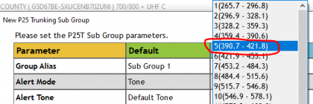

I might have figured out one thing. In the last screenshot above, look at number 5:
5. P2-05-0406.25-3485
My guesses are:
P2 means Phase 2.
05 means the pre-numbered tone ID number in the PPS software used for programming
0406.25 means the audio tone frequency is 406.25 Hz, which falls within the range of tone #5 in the PPS software: 390.7 Hz - 421.8 Hz. Evidently, the Unications can't be programmed with an exact frequency, only a range.
3485 I believe is the number of milliseconds of time that the tone was sounded for.
