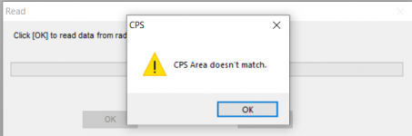

Great, it finally works. I'll program 6 radios for my FIRE DEPT.
Thanks a lot.
I'll get to work.
Muxlow
Super Secret
Aug 16, 2005
1,928
460
Middlesex County
If you see the CPS area does not match that means its not a NA radio its a EU or AS version radio and needs to correct CPS for that region
