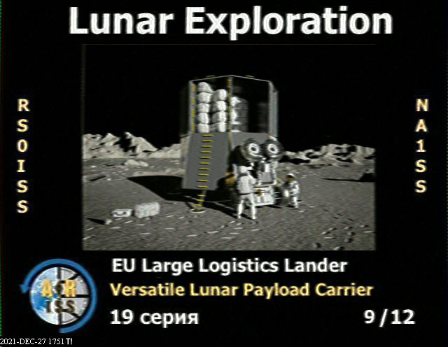

Here is image 9 of 12 from just a few minutes ago. Too much noise, but I'm not outdoors with a directional antenna, so we get what we get today with the rain. Token should have a nice image as it was close to overhead.
Was actually raining and snowing here during that pass, but yes, close to overhead and very nice pass.
The below results were done live using my R8600 and MMSSTV. I also record all passes using an RFSPace NetSDR, so I can play them back later if needed or if the live decode glitches. After this series is done, or after I have one of each image in good quality, I will probably do a series of videos on my YouTube channel, playing back the best recording of each image and doing a decode on the video.

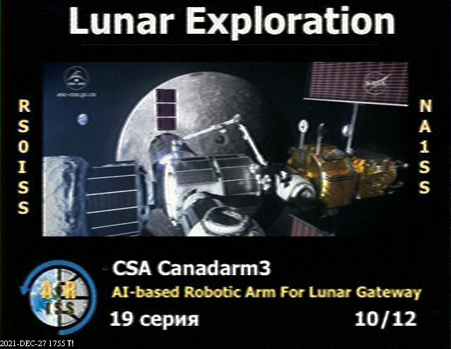

I figured out how to get the mmsstv software to work automatically with my Yaesu FT-991A hooked up to a Larson triband antenna. I decoded 2 1/4 SSTV images from the ISS on the first pass. Here is the best photo of the bunch. I'm going to leave the setup running overnight because I think there are some better passes coming up soon.
