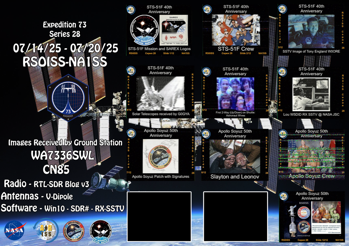

PDXh0b0
Mar 31, 2020
989
706
Woodland, WA
I see you also did not receive images 10 and 11. And at a guess, you only got a couple receptions of image 09, forcing you to use a less good image. Your SDR and V Dipole seem to be working very well for you.

Seen 09 twice, on the 14th only, first time was the one I used, the second was further E/NE at a °4 elevation, only received 1/3 of the transmission Screenshot (776).png

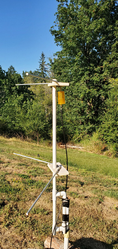

The v-dipole (built for weather sats) does quite well wikk ISS sstv, better then the qfh I use for weather sats
