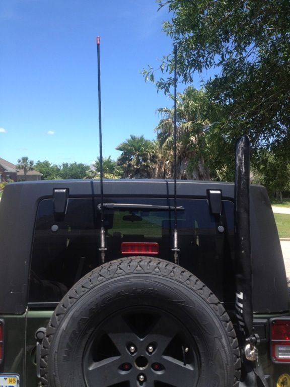

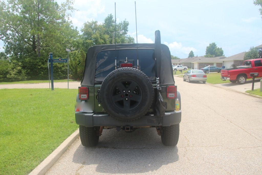

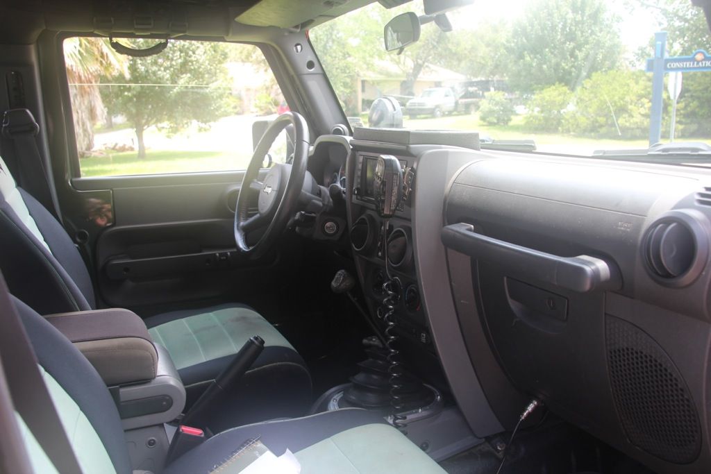

Here's my Cobra 75 CB installed:

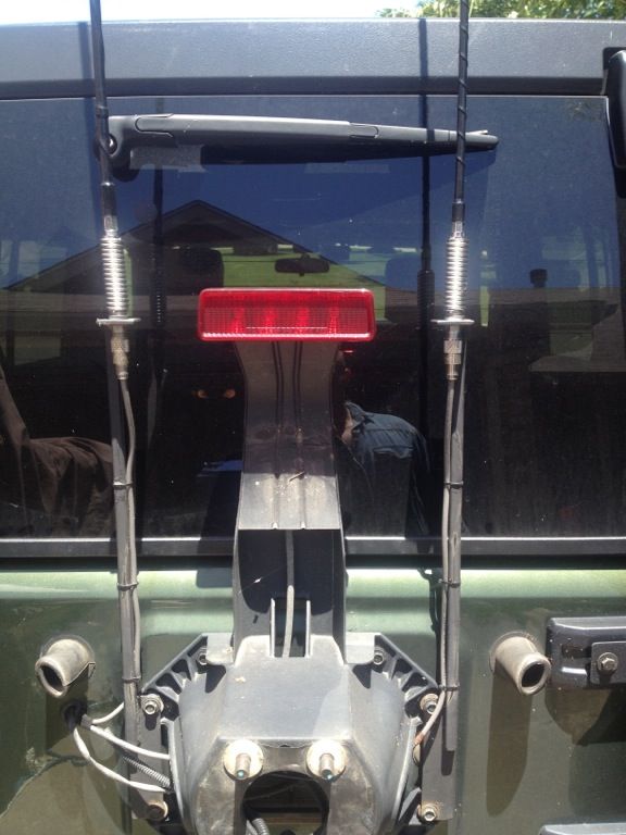

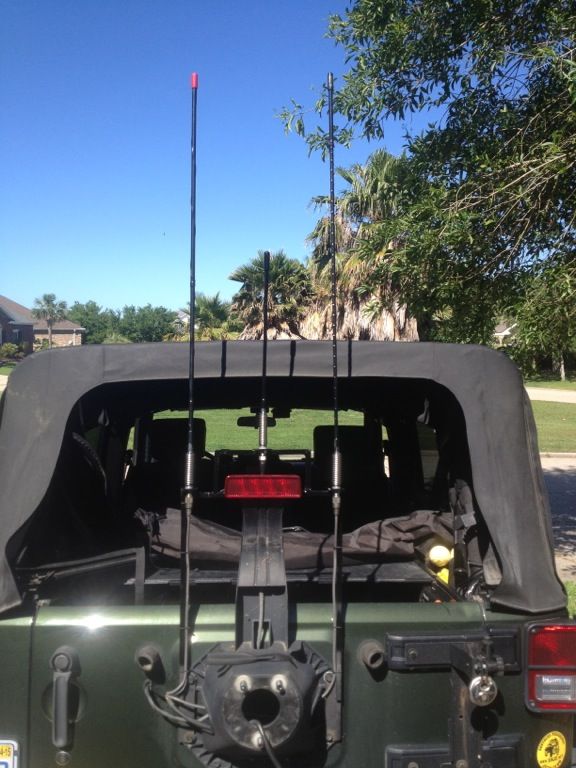

This is just a pic of the original Arizona Rocky Road mounts I had installed. 3ft Firestick CB on the left (driver) side, 3ft Firestick AM/FM on the right (passenger). Both are on Firestick Med Spring Mounts.
Same, but with the spare tire removed…

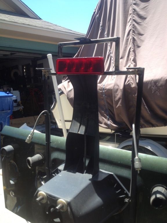

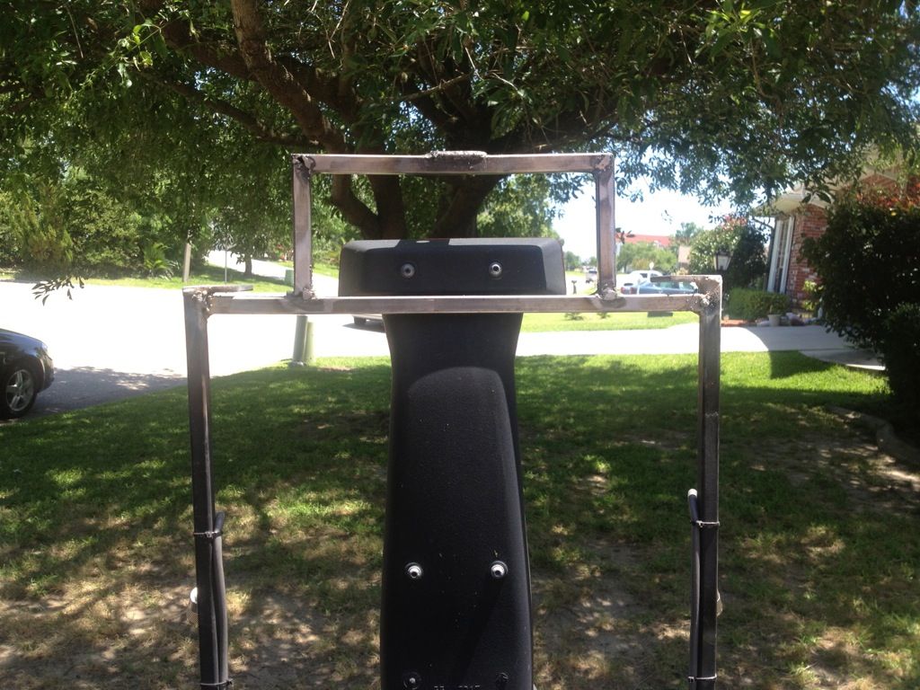

Since the mounts are made out of 1/2" square tubing, I went to my local big box hardware store and bought a couple feet of material to build my custom 3rd antenna mount. I started with a cross bar and built a raised rectangle to get the antenna above the 3rd brake light:
Once everything was welded, I added a small section of flat plate (1/8" thick) for the extra stud mount. Then I painted it black to match the existing coating on the original mounts. Next I routed the cables back up to the mounts and used small zip ties to hold them in place.
And here's the final version (w/o the spare tire). The middle antenna was a 18" Firestick MURS antenna I used with my scanner until I traded in the Jeep.
