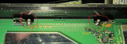

Sorry to hear you have to tear the rig down that far to service. If you do end up opening up the head you will need to use ESP Protection. You will also need to de-solder the two tabs that are circled in the below picture. If you can get a service manual it does have a very detailed troubleshooting guide for your exact issue. "5.1 Fault Diagnosis of the BGA (Ball Grid Array) IC
■Overview
A flowchart for determining whether or not the transceiver can be powered on (the LCD does not function even if the power switch is turned on) due to broken BGA parts."
Let us know what you find, I hope it is something simple.
Edit. I forgot to add remove the SD Card before doing anything internally.
Jim

Ok, oh-boy. This might be getting past my ability - lol. What good would de-soldering those 2 tabs do for me? Wouldn't that eliminate any power to the 2 connection points? By the way where is the SD card?

See post # 2, you also might want to check with a local Kenwood shop that DOES bench work.
The tabs that are soldered are only a physical contact, not electronic. Not to discourage you, but if you don't have experience in basic board level repairs then it should go to United Radio or another shop.
