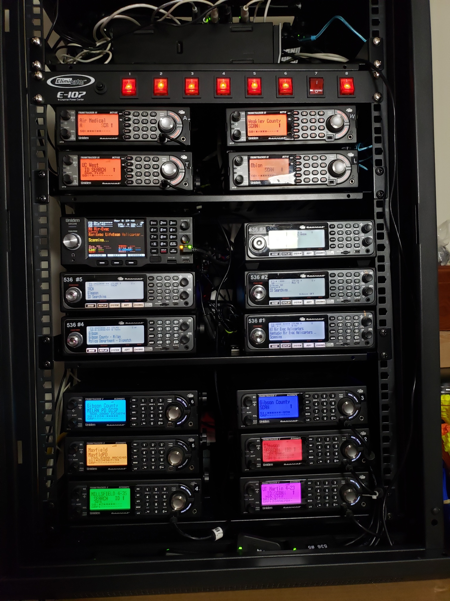

buddrousa
Jan 5, 2003
14,690
10,605
Here are the scanners
full
