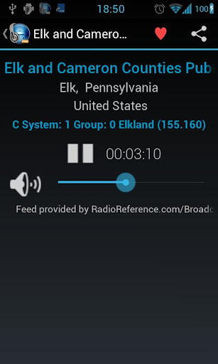

Hi guys,
Just released my latest app, MyScanner.
You can download it on Google Play
I appreciate if you guys could help me make it better by giving some feedback.
Thanks.

First impressions.
It took awhile for me to realize that the horizontal menu TOP50... actually slid to the right... to RAIL. Perhaps add a < or > to appear as appropriate?
Searching turns up unexpected results (or it needs a help file/explanation). Looking for "burlington nj" returned items in WI, CA and elsewhere. Only 'Burlington Area Storm Spotters' in Racine had 'burlington' in the name. Searching on "nj" yielded nothing.
Looking under one of the menu choices -- RAIL -- shows feeds from all over the country.
Maybe it is just me, but I like to drill down by location: country->state->county to find a feed.
HTH a bit.

Thanks for taking the time to review the app.
This is standard android tab behavior.
Hmm, just tested going to Menu then Search then US->New Jersey->Burlington, all the Burlington's feeds did appear.
The search icon on the actionbar(top) is only going to filter the results you are already seeing. This means that if you selected a different state or are in a top50 tab(top50, public safety, rail , etc) that hasn't Burlington there, you won't get that result filtered.
Going the country->state->county get's all your results for that area.
When searching for ex: "nj" try and search "new" or "jersey" and it will get you the results you want as long as the feed is available in that tab.

The "Nearby" and global search features are already available in the API. A couple scanners (like Scanner Radio Pro) already incorporate them.
You should also consider changing the non-descript unlabeled top menu button to something more intuitive. There really isn't any indication that it's a button.. Especially considering that it's the button you have to press in order to get out of the "Top 50" section and into the normal operation menus. It's just not what you expect to see in an important button.. Yes there's the < next to it, but I took it as requiring a swipe to the left to make it do something - which of course doesn't do anything.
Other than that I don't see anything glaring at me. It's a nice UI, especially with the dark theme (although there's a quick flash of the white theme on startup before it switches to black, which just makes it look a bit unrefined - it's something that'll only bother people like me who are OCD :D). Sound is good.

To be honest that's not really how a search feature should work. Search should be global and return hits within all categories. At the very least you should be able to search for matches at the state level without having to go to county - because at the county level there's really nothing to filter, it's already narrowed down pretty well. As is, the search function is relatively useless..
I know what you mean and I agree with you but the problem is that I've asked(also the author of Scanner Radio asked too) that search be implemented and Lindsay said they would do it after the transition. So I'm waiting for that moment to add a proper search function.
It's not available on the API right now, I've asked Lindsay to Include it and I'm hoping after the transition this get included. you can check what's available in the API to me right now by checking this pdf :http://wiki.radioreference.com/images/a/ae/RRaudioAPI_1.1.pdf

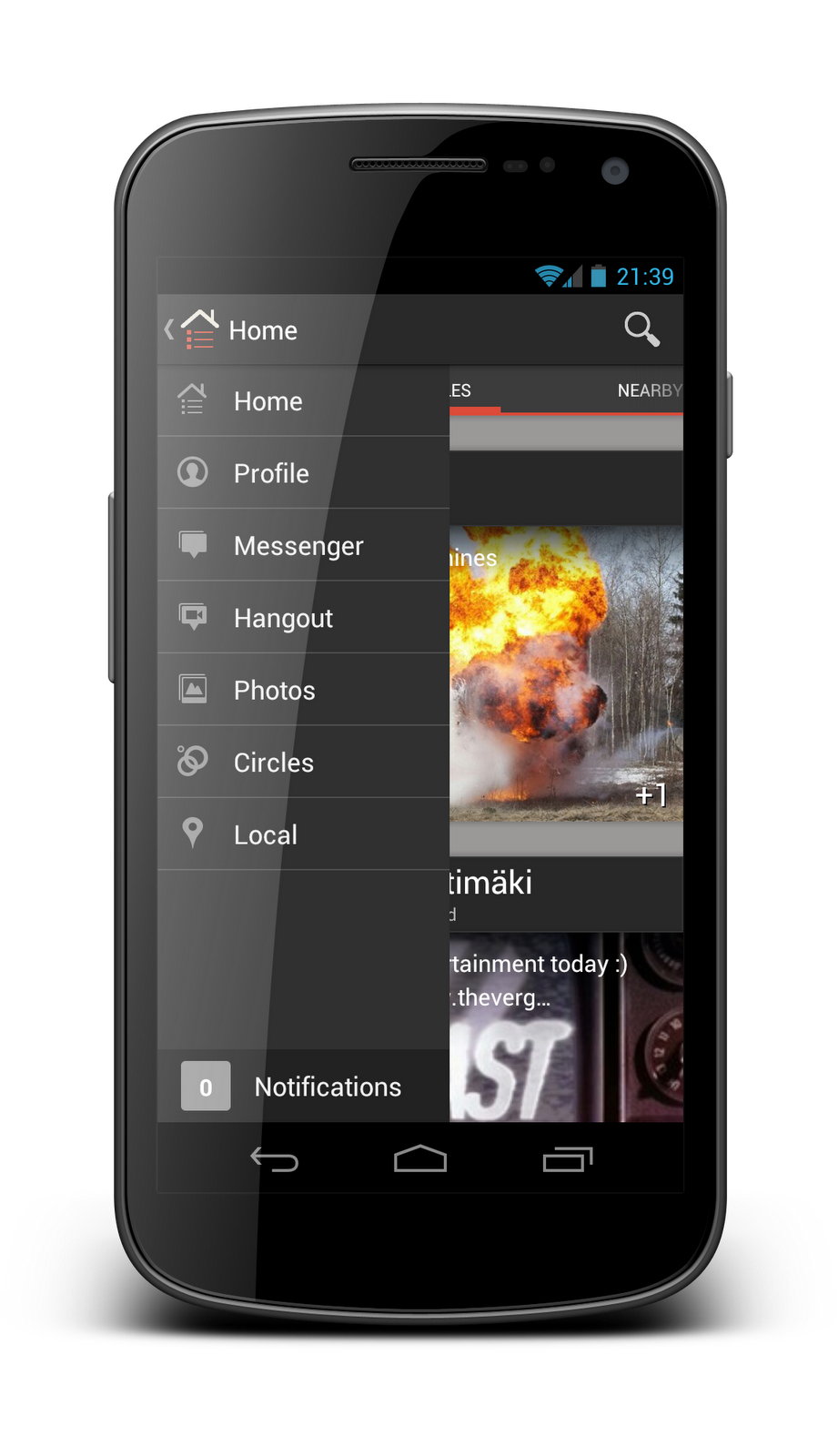

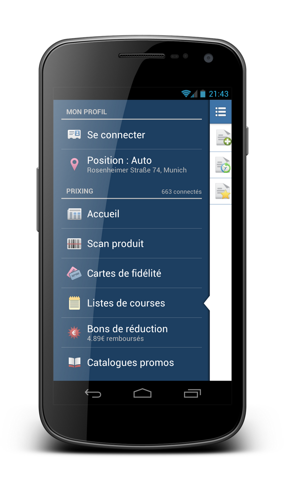

I see what you mean about the "non descriptive" button.
Checkout Android Design Guidelines regarding that icon. Look at Google+ app, the only difference is that they put a house to declare it "home". The Prixing app is a good example of this. I might change the icon so it's easier for the users to find the sliding menu.
I know what you mean about the flash. The problem is that ActionBarSherlock/Holoeverywhere library used to make me define in the manifest a "starting" theme and then I change it to the theme the user as selected. If I don't select the starting theme, a black theme will appear and then changed to the users selected theme. Don't know which is better. Will try to get a workaround but I don't know when...
