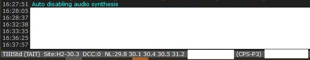

With TIII Standard CPS-P3 names wont show....
And there is "?" where in this case "H" should show. "H2" is set in all of the data files.
Shot of the CC part of it...

I take it the first screen shot is the VC side of a dual receiver CC/VC setup? If VC DSD+ doesn't know the network model, I doubt that it's going to use the "H2" radio entries in your .radios file, so I'd expect that no radio aliases from those entries are going to be displayed. The problem/bug isn't "not displaying aliases", it's "not picking up the network model" from wherever it's supposed to get it.
Yes. (the first screen shot is the VC side of a dual receiver CC/VC setup).
So, I might try and drop the Network Model in the radios file (Change H2 to 2) and see how that goes... I will report back with results.
