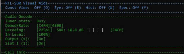

I tested 2.0.1-17 Nightly and this was the result. Vertical bars. Is it working correctly ?

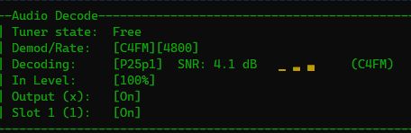

Or should it look like this ?
I will have a look at the networking side of it soon. I had a preliminary go at it. Cheers.
if your console doesn't offer the right unicode characters, which it doesn't based on your original post, then the code has to fallback to ASCII.
ASCII doesn't have anything equivalent looking: ASCII table - Table of ASCII codes, characters and symbols
the alternative is i don't show anything at all when this happens... which maybe isn't terrible? dunno, let me know you're preference. right now you'll just see the SNR "meter" move left and right adding or subtracting columns of those bars.

Ah, that means the font cmd picked on your machine doesn't have wide unicode support and my check failed to detect that... you can either pick a different cmd font (Terminal/Consolas/Cascadia Mono) or invoke dsd-neo with PowerShell instead, which I think should always have wide unicode support...maybe. I'm going to push a fix to actually fallback to ASCII when this happens.
I chose that font and it works.
Right click on the task bar and select "Properties". Then click "Font" and choose 'Cascadia Mono' (FYI for others out there).

WARNING: Input Level LOW -54.0 dBFS: raise source/input volume if signal is present
Sync: no sync
SPS hunt: trying 16 sps (sym=6000, demod=96000)
SPS hunt: trying 20 sps (sym=4800, demod=96000)
End of BP59.wav
NOTICE:
NOTICE: Total audio errors: 0
NOTICE: Total header errors: 0
NOTICE: Total irrecoverable header errors: 0
NOTICE: Exiting.
and this....
Code:
D:\SDR\dsd-neo-msvc-x86_64-native-nightly>.\bin\dsd-neo.exe -i BP59.wav -s 96000 -b 59
NOTICE: WAV input sample rate: 96000 Hz (interp=2)
NOTICE: Basic Privacy key loaded (forced priority): [redacted]
NOTICE: ------------------------------------------------------------------------------
NOTICE: | Digital Speech Decoder: DSD-neo v2.1.0-17-gcdf719d0 (cdf719d)
NOTICE: MBElib-neo Version: 2.0.0
Audio In Device: BP59.wav
17:45:34 Sync: +DMR  [slot1]  slot2  [31m| CACH/Burst FEC ERR[0m
Sync: no sync
17:45:34 Sync: +DMR   slot1  [slot2] [31m| CACH/Burst FEC ERR[0m
Sync: no sync
Sync: no sync
17:45:35 Sync: +DMR   slot1  [slot2] [31m| CACH/Burst FEC ERR[0m
Sync: no sync
Sync: no sync
Sync: no sync
Sync: no sync
Sync: no sync
17:45:35 Sync: +DMR   slot1  [slot2] | Color Code=XX | IDLE
[31m SLCO CRC ERR[0m
Sync: no sync
17:45:36 Sync: +DMR  [slot1]  slot2  [31m| CACH/Burst FEC ERR[0m
Sync: no sync
17:45:36 Sync: +DMR   slot1  [slot2]
Sync: no sync
17:45:36 Sync: +DMR   slot1  [slot2] [31m| CACH/Burst FEC ERR[0m
Sync: no sync
Sync: no sync
Sync: no sync
17:45:37 Sync: +DMR   slot1  [slot2] [31m| CACH/Burst FEC ERR[0m
Sync: no sync
End of BP59.wav
NOTICE:
NOTICE: Exiting.
and in both cases, there is no audio output
how big are these files? do you mind sharing them so i can take a look? SwissTransfer - Send large files securely and free of charge or whatever your preference is
