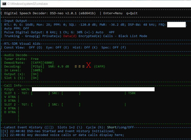

I also get bad symbols where the SNR meter should be (Se the red 'X') ?
Ah, that means the font cmd picked on your machine doesn't have wide unicode support and my check failed to detect that... you can either pick a different cmd font (Terminal/Consolas/Cascadia Mono) or invoke dsd-neo with PowerShell instead, which I think should always have wide unicode support...maybe. I'm going to push a fix to actually fallback to ASCII when this happens.

"Ah, that means the font cmd picked on your machine doesn't have wide unicode support and my check failed to detect that... you can either pick a different cmd font (Terminal/Consolas/Cascadia Mono) or invoke dsd-neo with PowerShell instead, which I think should always have wide unicode support...maybe. I'm going to push a fix to actually fallback to ASCII when this happens."
I run from a batch file. So that must be cmd (as in my screen shot).
So, I can run PowerShell and launch DSD-neo ? I will try that.
"pick a different cmd font (Terminal/Consolas/Cascadia Mono)"
May you please throw a dog a bone and explain how one does this ??
I use "mode con: cols=119 lines=64" first line of my .bat file. Can one specify font in this manner may be ?
I am after a hand up and not a hand out. Appreciate your time !
"I'm going to push a fix to actually fallback to ASCII when this happens."
I am pro that decision ! It would look better to new users and old users. -Good idea ! I don't mind awaiting new future (mainstream) release.
I don't mind spending a little time in beta testing. The least I can do ;)
The networking bit. Appreciate your input there. I will have a look a little bit later and mull over what you advised (little bit technical). I am always willing to learn a bit more about networking.
For simplicity sake (in describing my set up), I have two PC 's. One with 8 SDR's (closer to my aerial) and another that I use with DSD-neo. Both PC's connected over LAN.
Also, I will check Firewall rules (Ports 7355 and 4532).
Love your work !
Yep, if you’re launching from a `.bat`, you’re in cmd unless the batch file explicitly starts PowerShell or Windows Terminal.
You can absolutely launch DSD-neo via PowerShell from a batch file. Something like this should work:
powershell -NoLogo -NoExit -Command "& 'C:\path\to\dsd-neo.exe' [your usual args here]"
If you have PowerShell 7 installed, the command may be `pwsh` instead of `powershell`.
One small gotcha: if PowerShell is launched inside the same old cmd window, it may inherit the same console/font weirdness. So if the Unicode display still looks broken, try opening PowerShell directly from the Start menu or Windows Terminal, then run the same DSD-neo command there.
For the font: `mode con: cols=119 lines=64` can change the window size, but not the font. Fonts are set through the console window settings.
In classic cmd:
- right-click the title bar
- choose `Properties` or `Defaults`
- go to the `Font` tab
- pick something like `Consolas`, `Cascadia Mono`, or `Terminal`
- hit OK
`Properties` usually affects that shortcut/session. `Defaults` affects new console windows more broadly.
If you’re using Windows Terminal:
- open Settings

using DSD-NEO in TCP mode, it works fine, but I'm getting "WARNING: Input Level LOW -120.0 dBFS: raise source/input volume" each few seconds when there is no signal, is there a way to fix it?
I’ve put together a fix so connected TCP streams that are just silent won’t keep printing the LOW input warning, while the input level feature still stays active for real low-level audio, hot input, and clipping. The UI/docs also now clarify that low input only needs action if a signal is actually present. Next commit to main/nightly build will have the behavioral adjustment.
