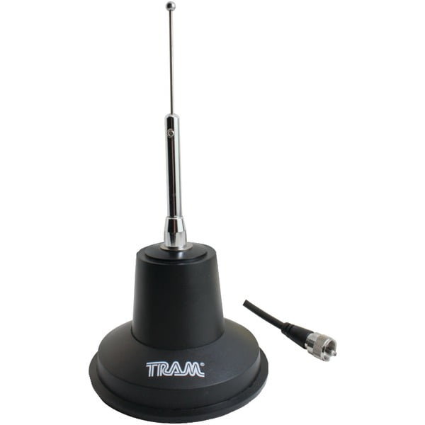

it say's human or robot but that's the link to a walmart Tram 3500 that works pretty well for me.

I know you can't Drill a hole so as K6GBW said a good mag mount is the way to go..... you can put the mag on the hood when you're in the woods now you can see it and it's out of danger.... then when you're on regular roads you can slap it back on the roof ( mark the spot as it will change the SWR a little) .... just so you know... you may go to all this trouble and find the skip loader or logging trucks... I forget what you're trying to reach.... but I see a lot of loaders with cheap radio's that can only do a couple miles... and that's fine as they only want to talk to the truck pulling into the yard a mile away... anything more is a waste and will get people bothering them with foolish questions and radio checks..... so you may do all this and find the people you want to talk to can only talk a few miles even if you can do 5 or 6 miles
I would change the radio too as W6GBW mentioned... I was surprised the Cobra 75 has the noise reduction... Digital Noise Cancellation – Transmit and receive communication with ultra-clear sound quality with DSP (Digital Signal Processing). big surprise... I'm sure it would work fine. I've heard many good things about it.
but if it was me... for $85 bucks this weekend at Amazon the Radiodditty C-S 47 is on sale for $85 bucks,,,, it's a tini tiny radio ( normally $95 bucks) it DOES HAVE the noise reduction technology.... it also has a simple modification that lets it put out 8 watts AM and 15 watts FM ... it will also allow you to go into the ham bands... so you will get another 400 or so channels... it has HUGE heat sinks in the back to get rid of all that heat when using all the extra power.... it's made for USA and overseas.... overseas they can have more power and channels... so all you have to do is move a pin ( jumper) lift it off mover it over and put it back.
that radio Radiodditty CS-47and a good magnet mount and you should be able to do just what you want. ...
for the price of the Tram 3500 it works extremely well..... 67 bucks at Walmart... you will have to order it on line and have it delivered to your local Walmart.... but like anything that works well... Tram stopped making them!

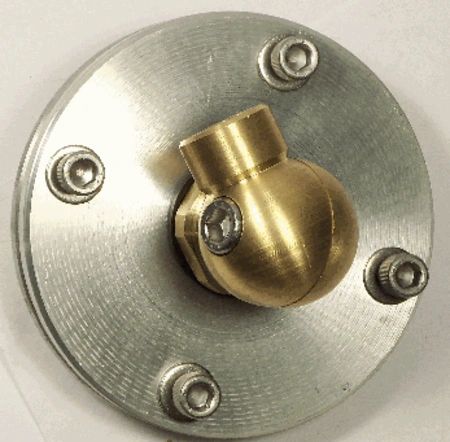

@prcguy has ideas/advice about using the truck bed interior wall to ball-mount a 102” whip. To me that looks better than roof mount in your job. It’d be a 48” base on my pickup, so the last few get to 13’ TTL gives some leeway.
As he’s also a 4-whlr and present/past truck owner, I’m hoping he’ll show up given his interesting & long history with on/off road HF.
But only you know what is best as to clearances.
In the big truck I go to 14’ with 7’ antennas. I might get off-pavement, but I sure don’t get off-road. Same with my pickup. And I’m careful about clearances. I don’t sweat highway 13’-5” clearances marked.
Top choice:
Mine is a roof-mount. Shown because it’s a sturdy-as-hell BREEDLOVE. But I wouldn’t have it in roof if I went off-road. Getting a little above my 35’ travel trailer with a more rigid 7’ is important. A 7’ puts me right at 13’ with a flexible whip, and it’s a couple feet above trailer (minimum).
I can run most any antenna, and, stationary, pop in a 102” to hit 15’ with no-compromise mobile performance.
