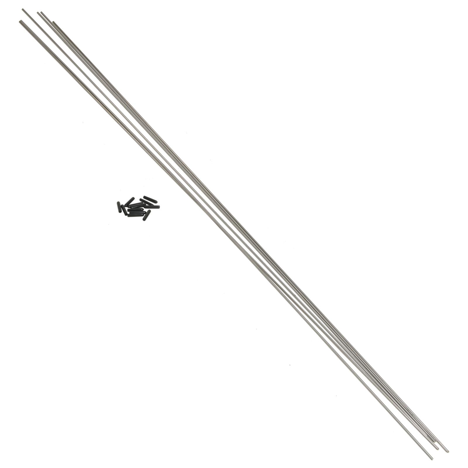

Unless Ive missed it reading back thru all of these, it seems the NMO 34 and 64" ends up with a center closer to 29 MHz so obviously not too good for CB. Adding a spring isn't going to bring that down enough to get it to the CB band. Has anyone found a 72 or so inch whip that will fit in that coil base on the NMO 34?
Corrections made several times now.
I’ve been looking for the 71’ SIRIO replacement whip for my pair of 5K-3/8. (Not in stock). Haven’t found other.

@mmckenna will the base take a .125 without drilling do you happen to know? Also what about the spring? DX has these but they're .125 according to specs.

Yes I read that. I believe the standard one is .100, my question was "would I need to drill it to accommodate the .125?" I understand it can be drilled, I was asking if I would need to or not. Also I don't think drilling on the spring has been discussed. Again, will the standard .100 size accommodate the .125 without drilling?
Never had a reason to try. I'm on the road the rest of the week and won't be able to check. My gut feeling is that it will not. It's purposely a snug fit with the whip so it stays in place and there's not a gap for crud to accumulate.
The whip does not attach to the spring in any way. The cone screws on to the top of the spring and the spring screws on top of the coil.

I’d drill, but OTOH, those DX-E pieces appear to be rigid; are without the flex I’d want for a whip.
My 13’ TTL height base-load antenna whip hits obstructions on a somewhat regular basis (no spring). PRESIDENT has/had a video where the Texas 1800 antenna can take 100-MPH strikes without marks, much less damage. My confirming experience thus far is at 60-MPH and lower.

We've ascertained the W640 is 64 inches long, we've also ascertained by several posts from actual tests, it's resonant around 29 MHz. While occasionally I get up around the 10 meter repeater range, it's rare any more these days while mobile.

You're likely correct about them being rigid. Frankly they're cheap enough and for testing to see if the NMO 34 would come down to the CB band, honestly it's been the only smaller diameter "whip type thing" I could find that might even work for testing.

Had to think on this.
The "QCone", in Larsen part naming convention, comes in 3 different sizes. The NMO27, as well as the NMO30, etc. are designed to use the 0.100 diameter whips. The hole in the cone is 0.100.
So, if you wanted to use one of those hammy whips, you'd either need to drill it out, or order the correct one from Larsen.
The part numbers are:
QCone.125 for the chrome version
QCone.125B for the black version.
Some of the antenna models do use a thicker whip, but not the low band products. Those tend to want the thinner whip for flexibility. The 0.125" whips are used on the wideband VHF antennas, as well as some of the 800MHz products.

Thanks. I appreciate it. I need to look I think I have a couple of Larsen mono band antenna coils out in the garage, maybe they'll have the right one.

NMOQWB (quarter wave wide band) antennas had the 0.125 whip, as did the colinear 800MHz antennas.
