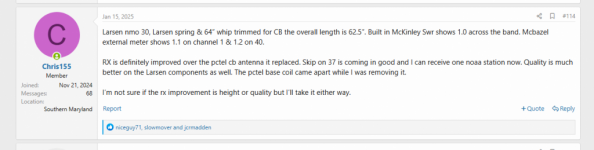

Yes....this post was about the NMO 34 however. (note the title). Also not to be rude but I'll usually not take any readings that are from a radio built in SWR meter athough I've seen them to be quite accurate for what they are but a SWR or 1.1 at one place and 1.2 at another place doesn't really show the curve. Was it resonant on CH 1 and then slightly went up on 40? Was it resonant closer to ch 1 and then dipped on ch 20 and slightly higher on 40? I dunno, doesn't say. Even on a MFJ analyzer like the 259 you can spin the dial and see the dip.

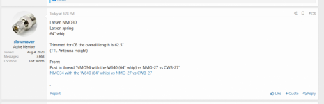

Pictured above is the post that comes up when I click the link in the post pictured below. Thread title is 64 but my post slowmover linked in that thread refers to the 30 and an external meter.1753824679371.png
Right. I saw it referred to the NMO 30, and honestly am not surprised it was somewhat better than the one you had that was "falling apart"? I think it said? thanks for the clarification however. I am honestly wanting to try the NMO 34 with the longer whip just to see what happens.
I think by now, we've ascertained the NMO 30 with the longer whip will work and work well in the CB band, I'd just like a little more. It may be I settle for the MNO 30 and 64 inch slightly tuned up higher for how I want to actually use it. If I thought 2 inches would do it, Wilson makes (or did make) a longer I think 66" whip, but I think it's gonna take a little more to get the NMO 34 down in frequency than that. I dunno maybe a 66 inch and a spring? I'll have to ponder on this some and see what I decide to do.
I can easily solve this by using an older Wilson 1K or 5 K and just use a UHF mount but I'm trying to make it look not like a CB antenna and frankly have had Larsen's for ham stuff for years on 2 meters and 70cm. Actually I need to see if they make a 1.25 meter antenna also, I've never looked.
Again thank you for the info! Glad you got yours working.

Our discussion here — like the links from WWDX and discussion by Ontario CB Club — both have the problem of just what are we discussing.
11M only (NMO30)
Or, wideband [sic] from there. (NMO34)

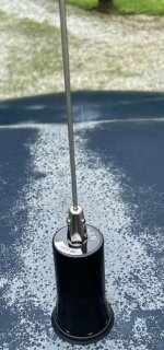

The plot thickens. Today I installed a permanent NMO mount in the roof on my truck (1997 Chevy C1500). I attached the NMO30 / W64 antenna, swept it with the analyzer, and... well:
Crikey! I expected the SWR to drop, but I didn't expect the curve to shift left by nearly 2MHz! I stopped there for the day to think about this a bit before chopping the whip down. Seems like a lot of material would have to be removed to bring it into resonance in the CB band.

That's interesting...did you get the just the antenna coil or did you get it with the 49" whip? Man I didn't expect it to drop that low even with that 64" whip on it.
I have only this 64" whip. I'm working on a way to figure out exactly how long the whip needs to be before doing any cutting- possible by using some wire and a bamboo pole to provide support.
