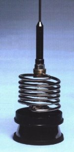

CWB27 was the model of this thread to copy

Can’t find the pic of the CW27 base coil cutaway showing that it’s more than just coiled wire inside.
This may be the nice exception to going to a 7’ for VG performance.
And it’s wide-banded for those who value such.
Post #14 here has it.
