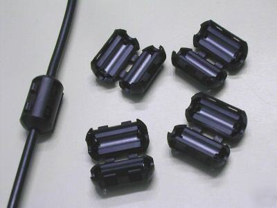

What do you mean by a few chokes?

A ferrite clam-shell choke would be the easiest to use.
http://www.dubuque-forsale.com/This...hoke-noise-suppressor-core-filter-picture.jpg
The longer and thicker the coke, usually will perform better. But it comes with a price tag. So, look for the best you can afford.
