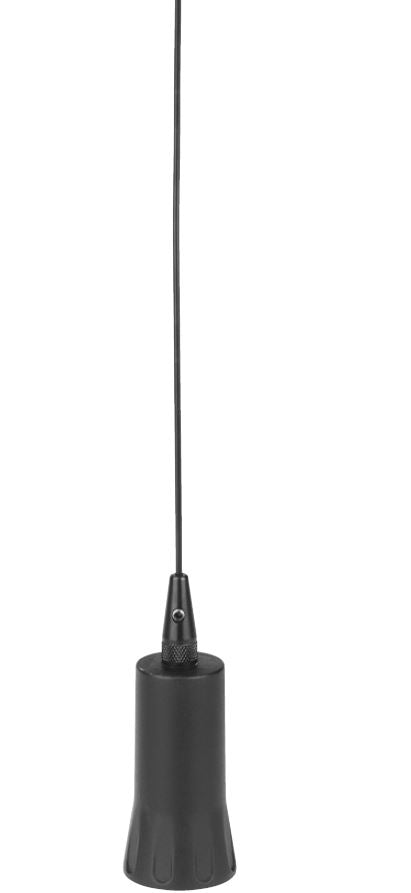

Google tells me that an NMO-30 is a magnetic mount.
Google is not correct. NMO30 is the Larsen part number for the antenna (whip and base coil). The magnetic mount would have a different part number such as NMOMM or NMOMMR. Many sellers may combine the antenna and the mount and sell them as one SKU.

Thank you for the correction. Is this the correct antenna mentioned?

It’s the one I’d work with.
But needs 64” whip to tune.

I note that there is also an NMO27 by the same maker. What is the reason or advantage to using the NMO30 instead of the NMO27?
