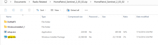

Thus what pops up when I downloaD that home patrol sentinel 2.03

Is there a way I can let u on my computer idc nothing on it I don't know if there's a way so u can do it all
hiegtx
Mentor
May 8, 2004
12,138
4,510
Dallas, TX
I do not have, nor use, remote access software.
This is really a simple process.
Click on the link for the Uniden Sentinel page.
Your PC will ask if you want to download the file, where to save it, and give you the option of giving the file a different name.
Once downloaded, the file will be in the download folder for your internet browser.
Find the file, and then double click on it, (It will be a zipped (compressed) file.)
Click the resulting file, which will be a folder with the actual files, to see the contents.
Double click on the setup.msi file to start installation. If you get a message about needing the "Dot Net" fix, see the comments on the Wiki I noted in post 24. Correct the dot net issue, then run the setup file again.
Once Sentinel is installed, then first run the database update.
After updating the database in Sentinel, then put the scanner into Mass Storage mode & use Sentinel to download the updated database to the scanner.

Ya I'm getting that dot net ****

I'm getting this error

The instructions to fix that are on the Wiki page I linked earlier. (There is a folder in the Sentinel Download file for "Dotnetfix". But that applied to earlier versions of Windows, such as Windows XP. For more current Windows versions, the Wiki page instructions have the correct procedure.
