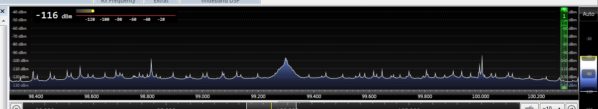

The USB ports are ok I will show you a screen shot and hope this is a starting help:
78385
