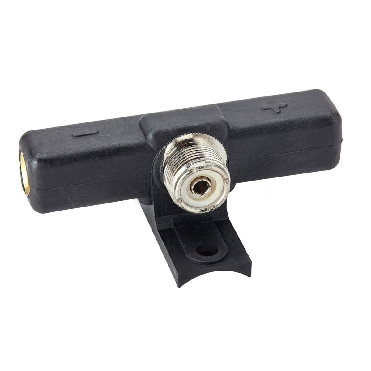

This inexpensive base pictured looks good for a vertical (Francis whips). A MOONRAKER item being carried by DX-E. DPC-38
