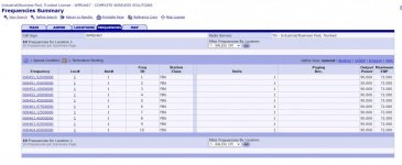

As mentioned above, The transceiver is NXDN as it shows "NEXEDGE" on the top front of the unit. "Complete Wireless Solutions" (from the sticker on the power supply) does provide an NXDN trunked system in the Salem area which they are likely using. Here are the frequencies listed in the FCC Database. I am sure that there are various users sharing the system. Hope this helps.
All good points.
However, it's not running in trunked mode. The display shows "MIXED", which is only available on a conventional system.
There is also no signal level shown on the display (top line) which would happen if it was listening to the control channel.
The "NexEdge" sticker is standard on all the radios. The radio will run analog, NXDN -or- DMR mode.
All we can tell from the photo is that it's mixed mode (analog/digital) and not on a trunked system.
