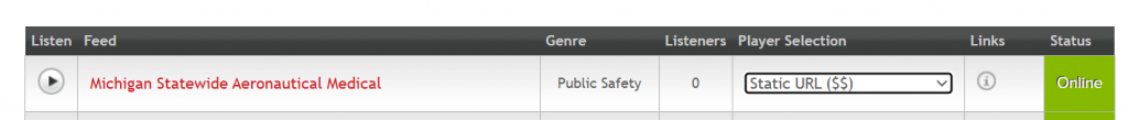

The website is still up, and that's why I posted the update a few months ago.
It looks like RR finally made their change to the new API.
To set up a feed, go to Broadcastify and select the static URL.
When you press play you'll get something like:
https://audio.broadcastify.com/4173.mp3
Copy that URL and head to ScannerLive. Add a new manual feed, and insert your Broadcastify username and password into the URL first, so in this case you'd add:
https://username:password@audio.broadcastify.com/4173.mp3
You'll be back up and running!

I think it will need a premium membership now. I tried the static player on the website and it then asks me for a login but I'm already logged in and can check my profile at Broadcastify and when entering my login credentials that it asks for they are then not accepted.
You'll be back up and running!All Greek to me

Man...few days after I bought this too. Not that it's ScannerLive's fault, if there was an API change on the site. But just my luck LOL
Anybody know yet if we're gonna need premium for this now?
