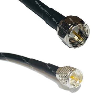

I know it's bad haha, waiting on an adapter for mini UHF to the regular coax connector to arrive. Just taking a while.
I bought some of these for my setup, they work beautifully, and no adapters lol
They sell a TNC version as well for your Harris needs
