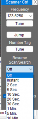

My 200 stops on a channel when active. While still active after 3 sec, it beeps and scans again even though the call was still going on. It stops on the same ongoing active TG. 3 sec and scans again or search what ever I have it set. NO Priorities, WX or CC on. I reset scanner and loaded all systems again and the same results. I took a new card and loaded 1 system on it. Any TG active it will stop on for 3 sec and beep and scan again. The 2 sec delayed does nothing because the call hasn't ended. Purchased 11/2019. Never has any priorities CC or WX ever been programmed in it. I finally turned off key beep.... No more hair left to pull out

The only thing I can think of is that you have negative delay set, but 3 seconds isn't an option.
