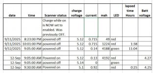

DMFalk & Ubbe, Thanks for replying. I (think) I did what you asked. I set the scanner to charge while on and enabled it. I kept the scanner powered off overnight and took a few measurements over the course of the evening and the next morning. If I understand the system/measurements correctly, I think my battery is probably OK. I'll know more after using it not powered in for a while. Hopefully my attachments will come through.
It looks like it charged fully overnight. Green LED in the morning whne I checked it. Batt voltage is 4.27.
See attached.
Thanks for the help.

It appears my battery is not damaged. Probably due to the setting of "charge while on" being disabled> I am pretty sure it just ran dry over the course of the past few months of being on 7/24.
My question is: What is the best way to operate my scanner (pretty much 7/24) and not damage the battery?
Continue as I have, and just shut it off every few weeks and let it recharge overnight? Or just set it to "charge while on" and forget about it?
Is the integrated charger smart enough to know the correct charging profile for the battery (type/size) and will automatically shut off or go to a "float" charge when the battery reaches its full charge so as not to damage the battery?
Thanks
