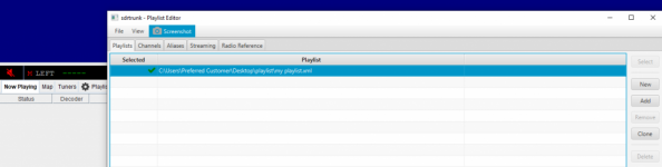

Playlist editor, playlists select & delete
Or go to
C:\Users\yourusername\SDRTrunk\Playlist
Delete the .xml

Not that I am looking to delete mine, but in beta 6 its greyed out.
Is the a channel running? I only used 6 long enough to get running with my rsp1a, went back to 5.1final, upped to 5.2 final, its been running about 2 days no hiccups.
So I guess the surest way is just to shut down sdrtrunk and go to the C:\Users\yourusername\SDRTrunk\Playlist
And delete the .xml
