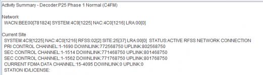

I have NO idea why I can pick up that county, but can't pick up my own. Absolutely odd to me. Although... I was using a cheap little cable TV splitter for a while to split the signals to different spots in my shack. I took that out of the mix when I discovered that my own county's P25 system wouldn't go through that (even though every OTHER county's system would). Now, here we are, and the dongle is happy with Boone County, but not my own. Maybe there is some sort of a gremlin somewhere on my county's frequency?
I'm completely lost for answers. :)

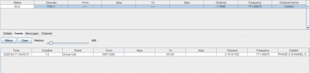

Maybe it's a bad dongle. Don't know. I've ordered a new one (seeing as this one is about 10 years old, and I'm sure things have changed since then). Interesting to note, that while RRDB 771.76875 as one of my county's frequencies, the SDS-200 shows that it's actually picking up on 771.46875. (And it's using the other frequency of 772.56875.)
I am thinking since the db only lists 2 freqs for Greene site, 771.76875 and 772.56875, and the sds is saying its receiving on 771.46875, I would add that freq (771.46875) to the 2 freqs in SDRTrunk. Possible all the sites freqs were not submitted to the database..

This was a comedy of two errors, it seems....
1) I switched from my discone to my dual-band (2/440) antenna.... and bingo, we're up and running. Cooking with gas. High flame.
2) We do need to update the RRDB with the new frequency, as shown here:
There needs to be 3 frequencies shown now for Greene County. I'll submit that change request.
