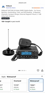

Looks like the Midland MXT500 is going to be a done deal today. Amazon Prime Days has it on sale. It even comes with a 2.1 dB UNITY gain mag-mount antenna!!!

The MXT500 is easy to use and easy to program through the radio. The antenna is not all that great. But the nice thing is the magnet mount is a NMO connection so you can always replace the antenna with something better. And the magnet is pretty strong.
