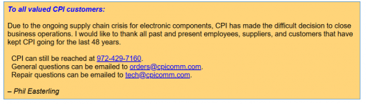

Call CPI they will most likely help you out --
You might also consider a step up to a Telex Console with a IP-223/224 Adapter and IP-3002 Deskset.
Or an ETC unit --
Sep 2, 2025
3
Thank You, I was at their website, but it looked like they had been out of business for a while, so I wasnt sure what the chances were they might still be available.
