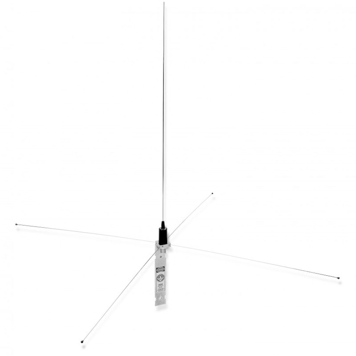

Anyone here know what kind of antenna i would need to just listen to the transmissions?
28,561
36,696
Something like this would be an inexpensive option:
For receive only, just about any antenna will receive airband signals (118-136 MHz and 225-400 MHz). However a tuned antenna, one that is specifically made for airband, will be more efficient and receive signals from further away. @mmckenna made a good suggestion for a tuned antenna.
Thank you.
