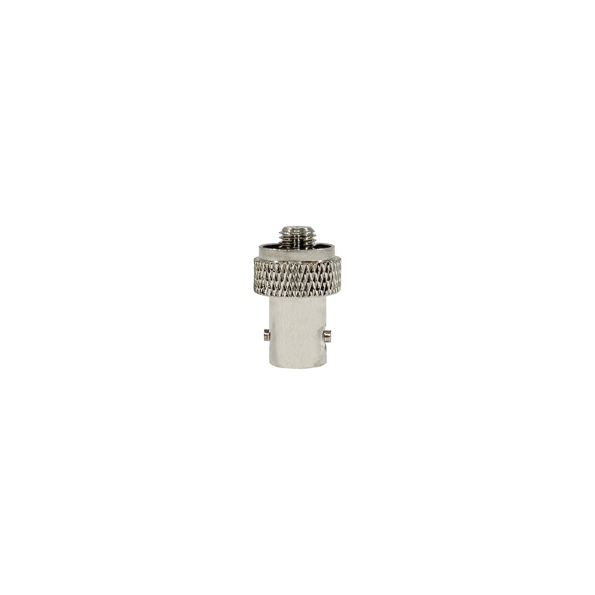

K2NEC
Oct 23, 2017
3,704
2,572
5F6
Not on that radio. Don't they use the same stupid antenna connector as the 7550? I seem to recall that. You need the ridiculous "adapter" for connecting the radio to a service monitor.
They exist
alcahuete
Jul 24, 2015
2,890
2,825
Southern California
They exist
Does that actually work? I thought the working ones were oveer $150 or so.
