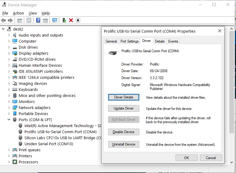

Give it another try... I just installed the driver earlier this afternoon and it works as always. The installed Prolific driver is dated 7/31/2007.
For what it's worth, 3.3.2.102 dated 9/24/2008 works also:
The last update forced on me a few days ago nuked the driver. Device manager said something about "outdated contact your manufacturer" or some nonsense.

Yes. I got the same message when I plugged in my cable yesterday, first time I've ever seen that. Fortunately I was able to use the same fix just as easily as I did last week.
