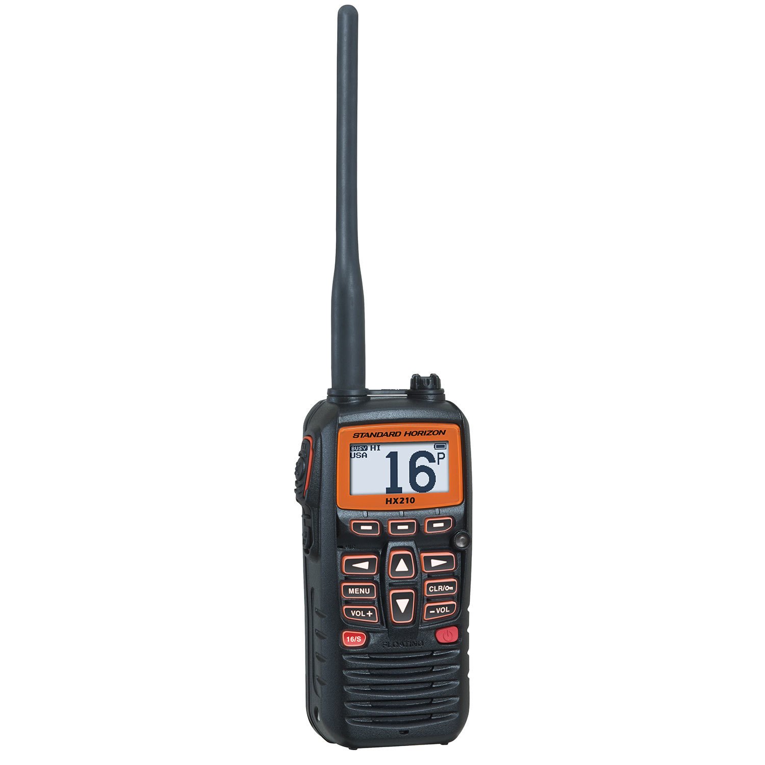

Going forward see the link below to a name brand Standard VHF handheld for $99 and this a much better choice. The channels will be correct and it's able to last in a damp marine area. The radio will have one button access to VHF channel 16 the distress channel, so it something happens to you others onboard the vessel should be able to use the simple radio. Marine radios are made simple to be able to used by non-radio types.
