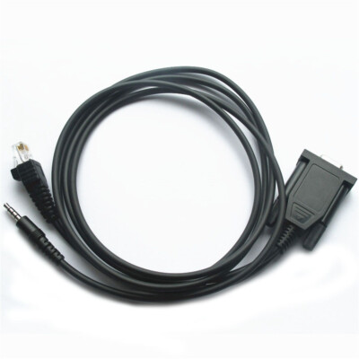

You need a serial cable and not a usb one.

I hook up the serial cable to the old programming laptop and it looks like its reading but never does. It does not give me an error message or anything. I tried unplugging the cable and it gave me an error message then.
Im about to purchase a USB cable online as I cant find a serial one and purchase the software online and use my newer laptop in hopes that that will work.

It's a DOS software, it was never ment to be used with usb.
I seriously doubt it will ever work. I wouldn't even try.
If it is a correct serial cable and Com port in the software selected the same as the one in the device manager it should just work.
Made in china Vertex RJ45 8-pin serial cables work just fine.

Is it the same programming cable as the Motorola cdm?
Wonder if I have a bad cable.

It may look the same but Motorola cables are different from Vertex. Many brands are using 8-pin modular connectors, but pinout is different.
My best guess you tried the wrong cable.
I will try to read my VX-3000 later today and see if any manipulations are needed.

I couldn't find a serial cable for vertex online but I'll look again
