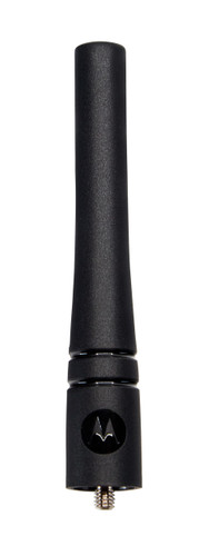

There is a firmware update available for the DTR 600/700 models if you don't already have the latest FW and CPS. The updated FW adds scan capability and fixes a couple of bugs. A stubby antenna (PMAF4025) is now available for them. I am using the PMAF4025 stubby antenna on my DTR700 fleet.
The same CPS cable used to program the DTR 600/700 is used to apply the FW update. It is an easy plug and play upgrade.
Original 1/2 wave antenna: PMAF4024
New stubby antenna: PMAF4025
The new CPS is R07.01 to program the scan capability in the updated FW.
I regularly check Motorola's website for updates and haven't seen any. Moto's site still has R07.00 CPS and doesn't show the PMAF4025 stubby antenna on the accessories tab.
