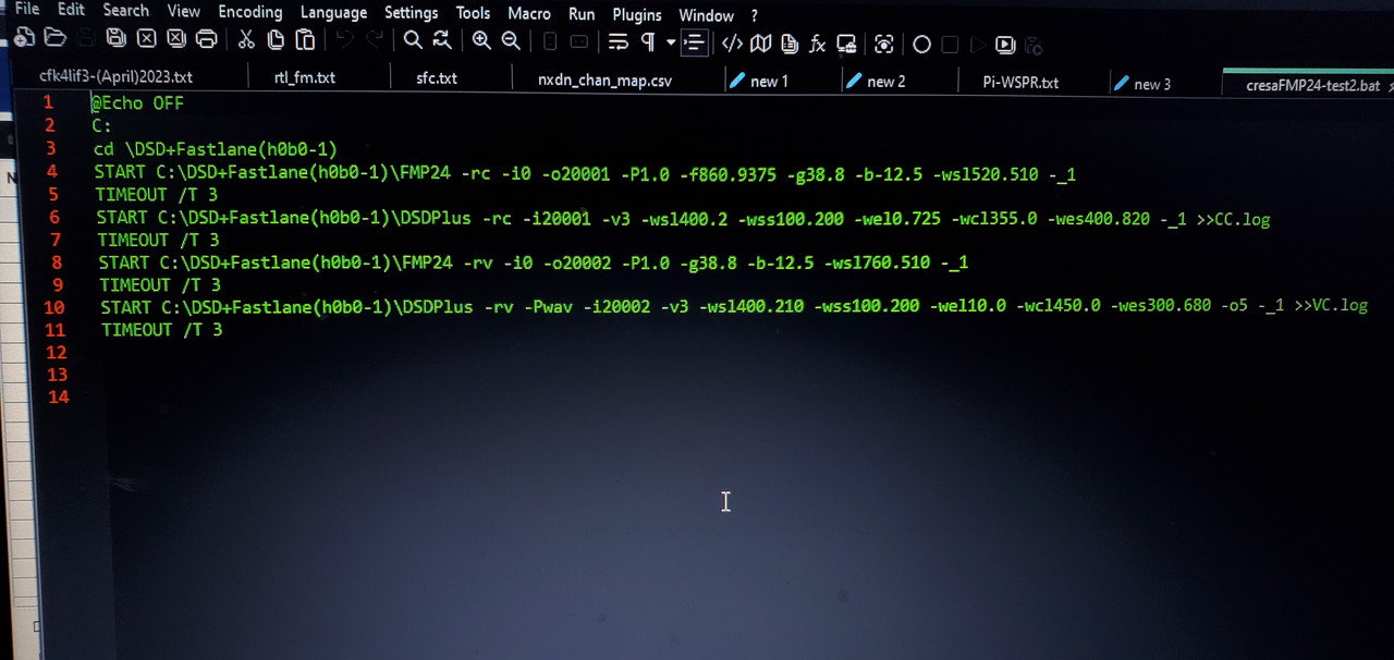

This is what one of my bat files look like using two dongles
