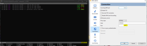

Yes you can specify port in command line, for example "mitmproxy.exe -p 5555". You will see the listening port in the bottom right corner of the console. Remember to set the same port in Zello and add parameter p- 5555 in Windows Task for automatic start at Windows startup. See below screenshots. Note I didn't have time to test the task parameter (last screenshot). Please report back if it works.

Hi guys, I found a solution that enables full Zello legacy app functionality as before (Enable TLS and Sign-in when Zello starts).
Just follow these two steps:
1. Install mitmproxy (mitmproxy - an interactive HTTPS proxy). You do not need to configure anything, the default configuration is OK. Just run mitmproxy from start menu or from C:\Program Files\mitmproxy\bin\mitmproxy.exe if you have disabled script execution.
2. Set Zello connection settings as in the screenshot below:
Now you will be able to normally login. When you confirm everything works, you can set mitmproxy to autorun with Windows and without the console. Just create Windows Task that runs mitmproxy.exe as SYSTEM on startup:
